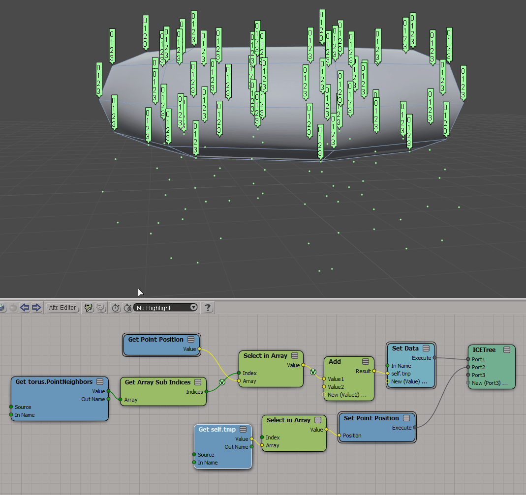

This is your basic construct. The points below the torus are the original point position before the simple Add operation, and the tags on each point on the torus show that the add operation is applied to each of the the four neighbouring points. You then set those new point positions based on the custom attribute you created for those point positions. Obviously you'll be applying your clever smoothing algorithm in place of my simple add (+2 in Y) operation; but the basic construct is the same.

hmm, so anything you put in self.tmp will be an array of per point data you can use on next iteration... nice
Somehow i thought port1 executes per one point, then port2 on the same point and then cycle goes to the next point, so this simple trick never crossed my mind

but wait...
No-no-no
What your tree does is just adding 2 in Y for regular points
Notice how self.tmp attribute of each point just contains the position of that same point
No-no-no

and even if we put neighbors positions in there (which is doable) the 'set point position' in port2 let us change the position of a current point we iterating through, not its neighbors.

My bad. Apologies for any wasted efforts.
