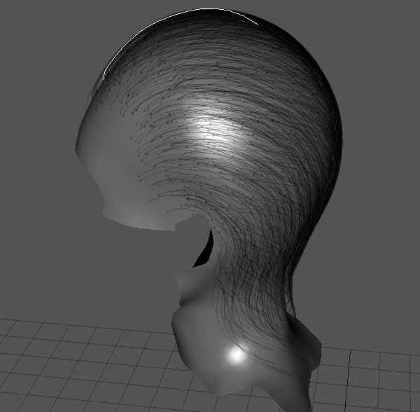

Thank you for the feedbacks Steven and Julian!
That's weird about the BeginEvaluate not giving you valid data, wasn't it working in your previous version? maybe some ICE optimization hitting?
Really cool plugin, btw I'm using it for hair (converting guide strands from 3D to a "UV&height" coordinate system. Interpolation is done in this system then and for the conversion back to XYZ I need the UV to position lookup)
It's a bit slow of course, going through each of 100.000 points, each has 40 strandpositions (=4.000.000) and then for each of these it has to test each uv triangle (8000*4 mil = 32 billion checks) ... still usable speed though.
this is only using 1 guide curve:
softimage resources section updated Sep 26th 2026
julian johnson
Posts: 9
Joined: 27 Apr 2010, 14:10
Re: code for review: a mod of Julians's UVtoPosition
Post by julian johnson » 10 Mar 2014, 14:17
What a great application! Looks superb :-)

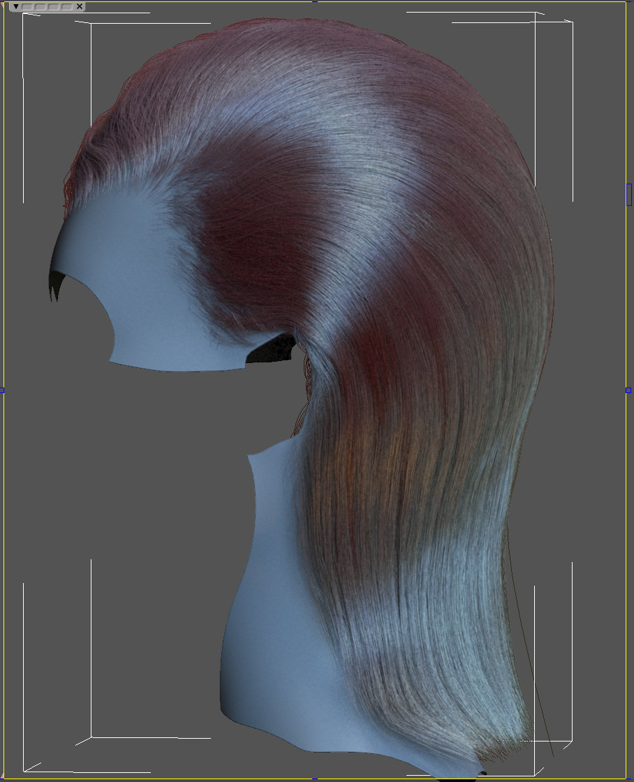

Posts: 1810
Joined: 26 Sep 2009, 13:51
Post by rray » 12 Mar 2014, 01:36
Cheers man. This approach looks quite promising, at least for this kind of hairstlye..
3 guide curves and some randomizations with kHair:
