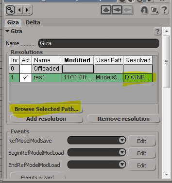

I know I once had it working, but can't find back how to exchange the master reference model ... so model A is the master reference for all instances and now I need to use model B instead ...
Anyone remembers ?

Just create a new resolution (the first option on the ref models PPG) and switch to it :)

cool, exactly the direction to go. I recognized that it even is enough to just "Browse Selected Path" to replace the Model with another one on the one resolution existing there by default, without the need to make an additional resolution.
