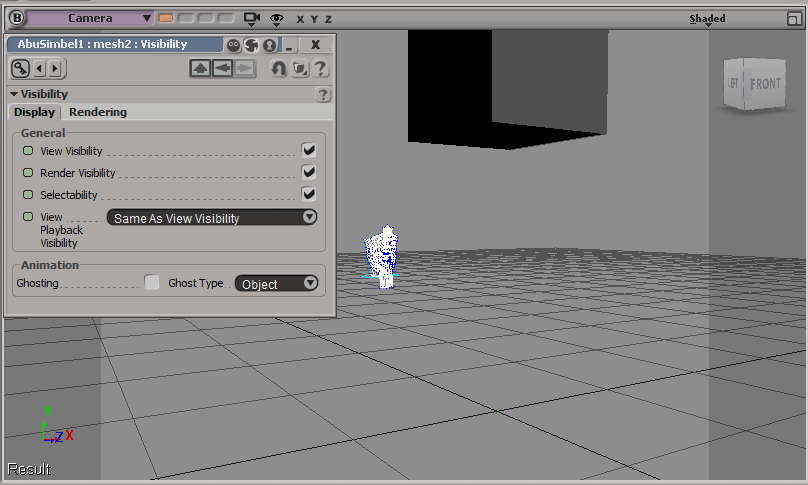

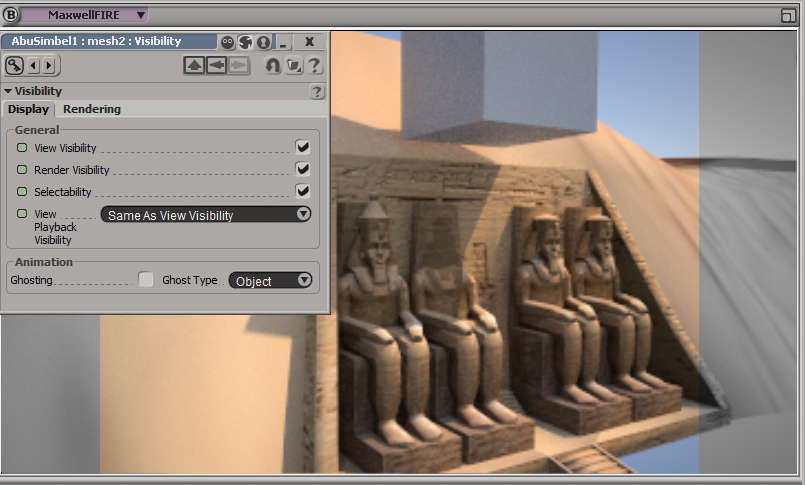

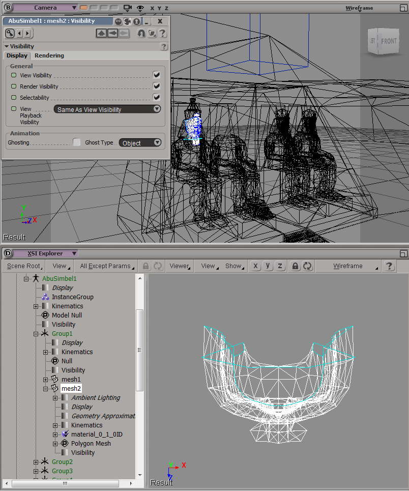

I've imported a collada file and trying to shade / texture decal it in the viewport, but it is only visible in the wireframe and final rendering, but not with shaded / texture decal. I've checked the display settings and it seems all ok there. Any hint why this is not coming yet ?

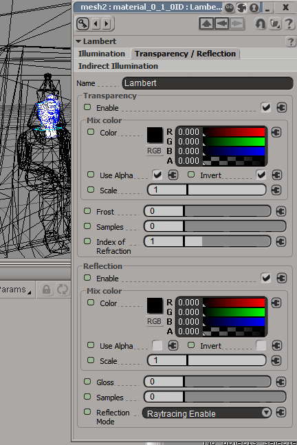

Have you checked your material, transparency is probably enabled somewhere.

ya, i had assumed and checked that and the surprising thing for me was that the transp. is at 0 but still wasn't showing the mesh fast viewport renders.

Yes, but uncheck the Invert option or uncheck the enable transparency option and it would be fine.

aah ok, yes that was it.
Thx !
