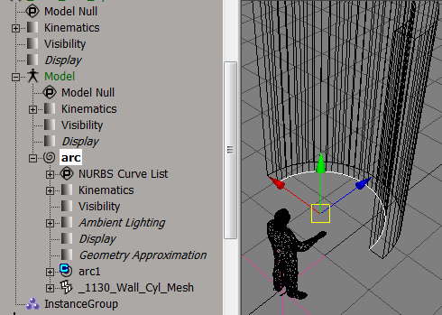

for example When extruding a mesh from a curve, then the relation between them leads to the case that I can't house them under the same hierarchy ... coz when I move the hierarchy, the curve and mesh wander around separate ... while i'd like to keep them nice and neat "together", so I have a tidy scene i'm working in ...
any hint how i need to put this to keep both in place with each other, when I'm moving around the hierarchy that houses curve and extruded mesh ?
I had managed it so far that when I put the mesh under the curve and "ChldComp", then everything works, but the tricky thing with this case is that I had create a curve, then a clone and then geve that clone an offset (keyvis) ... and now actually want to pack all three together for proper moving around.

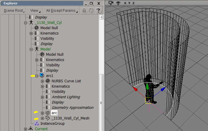

... finally fond out :
cloned curve and mesh go under the origin curve,
then constraining clone curves position and orientation to the origin curve,
then moving the origin curve with ChldComp.
