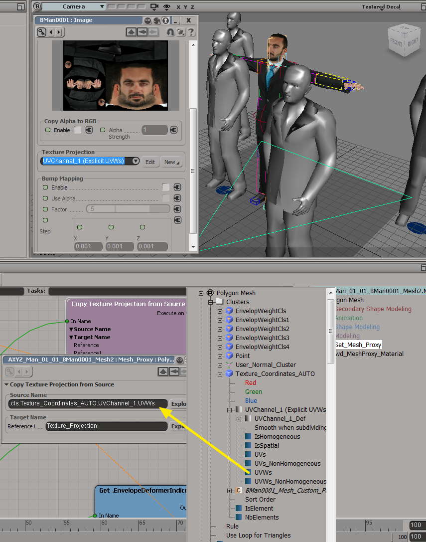

trying to get my Actor Copies to look like the Source Actor. Right now they don't show the texture that the source actor has.

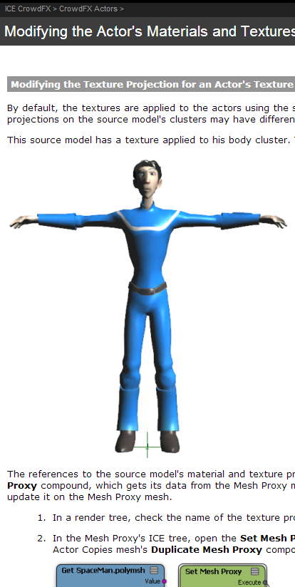

I'm following this:
but I still get that :

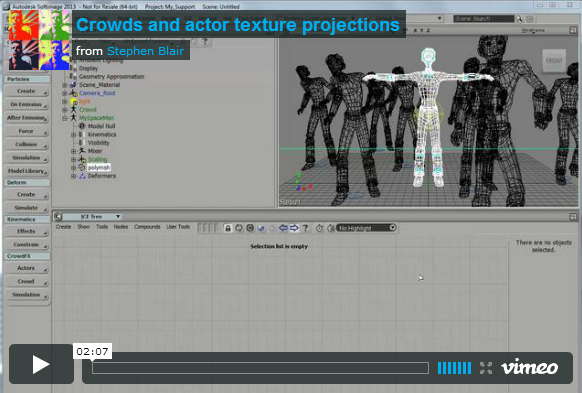

... solution video here from Steve (thx Steve) :
