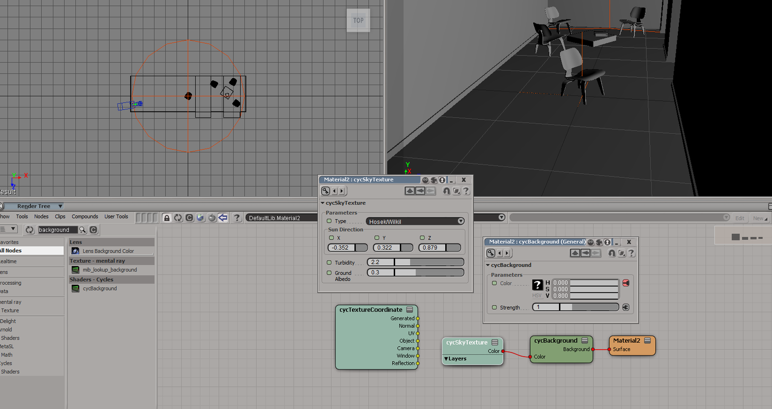

I ran into a problem with the sky and sun following the guide. Apologies if this was posted before.
1- When trying to follow the guide, I cannot connect the cycTextureCoordinate to the cycSkyTexture. It simply refuse to plugin or show any node to plugin to.
2- The cycBackground seems to be missing the transparency factor, so I cannot render the sky
3- Something strange also happens when switching from Nishita to Hosek. Trying to match the sun direction in Nishia is difficuilt, so following the guide I've changed to Hosek and added the sun direction. Now when switching to Nishita, it seems both the Hosek and Nishita sun(s) are overlapping.
Any help is apprecaited.
Thank you
Posts: 258
Joined: 30 Dec 2016, 19:18
Post by Shekn » 12 Mar 2021, 16:19
1. This is my bug, that cycSkyTexture does not contains Vector input. In most cases it should not be used, because the renderer automatically connect it with generated uv-coordinates of the background.
2. Parameter to change transparency placed in the render settings in the Background tab.
3. To change sun direction in the Nishita model - add sun light as subobject to the Background light. Then transforms of the sun light will be used to compute sun direction. Nishita model create it's own sun in the texture, so, it's helpful to set directional light strength equal to 0. In another way, you can turn off the Sun Disc parameter, and then the sky will not generate the sun.

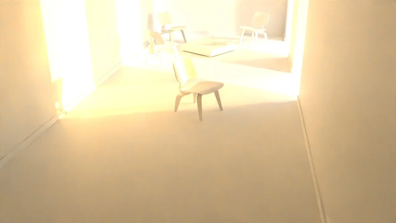

4. The light strength of the Nishita model is to bright for default sRgb color mode. You can either set a low strength of the cycBackground node, or change color space to Filmic.
