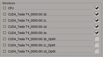

Hi Shekn
I have 4 Tesla cards that only show up as CUDA but only 3 show up as OptiX. is this a widget limitation that cannot scroll beyond that point?
Thank you
Thank you
- Posts: 258
- Joined: 30 Dec 2016, 19:18
Yes, this is my limitation. I hardcode the limit to 8 devices, but it's possible to increase the limit in the next update. May be to 1024 devices. 1k devices ought to be enough for anybody.
