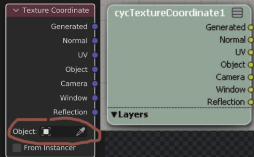

@Shekn Have we already discussed the intentional way of using cycTextureCoordinate Object output?
what is the equivalence of pick an object.
Posts: 253
Joined: 30 Dec 2016, 19:18
Post by Shekn » 20 Jan 2026, 05:13
There are no equivalence. As I understand it, this feature in Blender is not implemented within the Cycles renderer itself, but in Blender's integration. Therefore, it might be possible to implement something similar in Softimage, but I am not sure if it is actually necessary. It could be too complex and inconvenient.

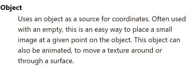

Post by opoppopopp » 21 Jan 2026, 14:29
It makes sense. Plus, I agree that it's not worth it at the moment.
Honestly, I still don't quite get Object Coordinate even after rending the Cycles documentation.

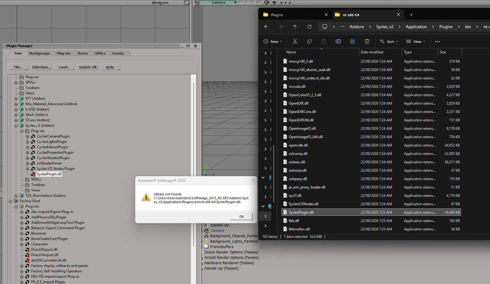

I've uninstalled the previous version of sycles and installed the new one. There are no issues when installing, however the render engine isn't added to the list of available renders. nothing on the console!
Any idea why would this happen? never had this issue before.

I am getting this from the plugin manager. Note that when installing the addon, it somehow generates a Sycles_addon.2.4.zip file that is 8MB at the same location where the addon was installed from.
Posts: 253
Post by Shekn » 23 Sep 2026, 03:55
When Softimage says "Library not found", it means that it failed to load it because it could not find all required dependencies. The bin\nt-x86-64 folder should contain 105 DLL files. On your screen, there are only 103 of them. In particular, the file tbb12.dll is missing, and one other. It is strange that some files have been removed. They are included in the latest distribution. So, my advice is to delete the add-on and remove all remaining folders. And then install it again.

Shekn wrote: 23 Sep 2026, 03:55 When Softimage says "Library not found", it means that it failed to load it because it could not find all required dependencies. The bin\nt-x86-64 folder should contain 105 DLL files. On your screen, there are only 103 of them. In particular, the file tbb12.dll is missing, and one other. It is strange that some files have been removed. They are included in the latest distribution. So, my advice is to delete the add-on and remove all remaining folders. And then install it again.
Thanks Shekn, but it's not happening. I did a clean uninstall, delete and install. downloaded the addon again, it is always 103 DLLs. in the past I used to be able to open the xsiaddon file using 7-zip, this time around I am unable to.
