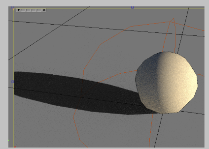

Does anyone know the best workflow to get a shadow pass from Sycles? I've been reading about the Shadow Catcher in Blender but I'm not sure how I go about using that in SI. It uses a render layers node, so I think the utilisation is a bit different for Sycles.

I remember just add "Mesh Property" and turn on "Shadow catcher" will render that polygon only with shadow.
@Shekn I must miss something, because shadowcatcher test scene is working, BUT only for Background(IBL) Light? other types light source seems not working?

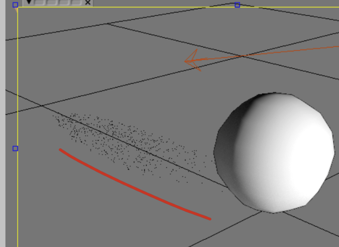

I think I'm up and running with rendering a shadow capture pass. In my scene I have a point cloud with instanced shape. Motion blur doesn't seem to work. I noticed this has been a spotty issue from posts going back to page 50 of this thread, with some reports it works OK.
Here is what I have done:
- motion blur enabled in render manager cycles settings
- created pointcloud sim
- pointcloud "instance shape" node selecting a mesh with a cycles mesh property. This has motion blur deformation ticked.
- pointcloud also has cycles pointcloud property. This has motion blur deformation ticked.
- if I also tick native cycles pointcloud, render result has non-instanced simple points that have motion blur. If not ticked I get the instanced mesh with no motion blur
Using Sycles 2.2.1.
Have I missed a step?
Using Sycles 2.2.1.

If I remember correctly, Shadow Catcher is broken in Sycles 2.2.x due to a bug in the Blender source code used to build the addon.
About Shadow Catcher in 2.3, opoppopopp is right. Something is not working properly. I will try to investigate it.

About motion blur. There is an issue (https://github.com/Tugcga/Sycles/issues/26) with ICE simulated instances. I cannot do anything about this issue.
SPJ, if this does not apply to you, send me an example of a scene that you would like to achieve. Then I might be able to understand what is wrong and why.

I managed to get the shadow catcher to work for me in 2.2.1. That said it was a simple scene with only one Cycles area light. I had to use the Shadow Catcher option in the render channel, which was the step I was missing to begin with.Shekn wrote: 26 May 2025, 15:33 If I remember correctly, Shadow Catcher is broken in Sycles 2.2.x due to a bug in the Blender source code used to build the addon.

I'll send you the scene, which I'm looking to enable motion blur on the pointcloud. It also has the working Shadow Catcher in a shadow pass. If that's helpful to look at, then check it out as well.

Fix the shadow catcher. It now works not only with background light, but with all other lights too. The native Softimage light always has the shadow catcher activated.

I used Sycles 2 and the shadow catcher to create this wee mixed media piece. Pretty happy with it
Thanks opoppopopp and Shekn for the advice!
