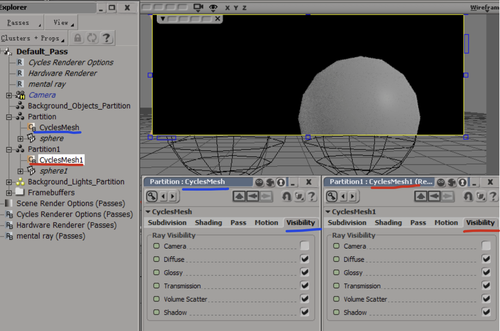

"Cycles Properties" only work by its default name? (e.g. "CyclesMesh" for polygon)
Names like "CyclesMesh3" won't work?
So that apply properties to Partition/Group can not work?
BTW.
"// INFO : This property can be applied only to polygon mesh object"
So I drag or "selection(0).AddProperty('CyclesMesh')" to apply it to Group/Partition

It seems that the engine now searches for properties by name. It's inconvenient to use. I'll try to understand how it's possible to recognise property by its type. And also add possibility to add property to partition.

Don't know much about C++, but how about search for Name" CyclesMesh* " instead of "CyclesMesh", so that "CyclesMesh1...etc." fit. Will just solve the problem :D
Since I do a little scripting, will this help? https://xsisupport.com/2013/10/30/findi ... s-by-type/

Yes, something similar is required.
