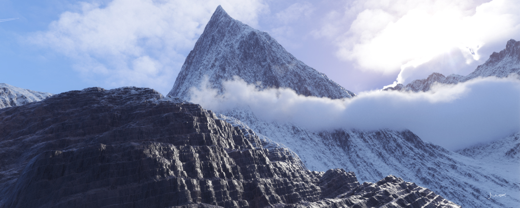

allright, here is an image that took me around 7 hours rendering, i kept working on that mountain peak last image, added some strata variation on the foreground rock, fixed snow, and added clouds, better atmosphere, little post in ps.
if u wanna see them full resolution, right click on the image > open in a new window, i dont know how to link them here full res :)

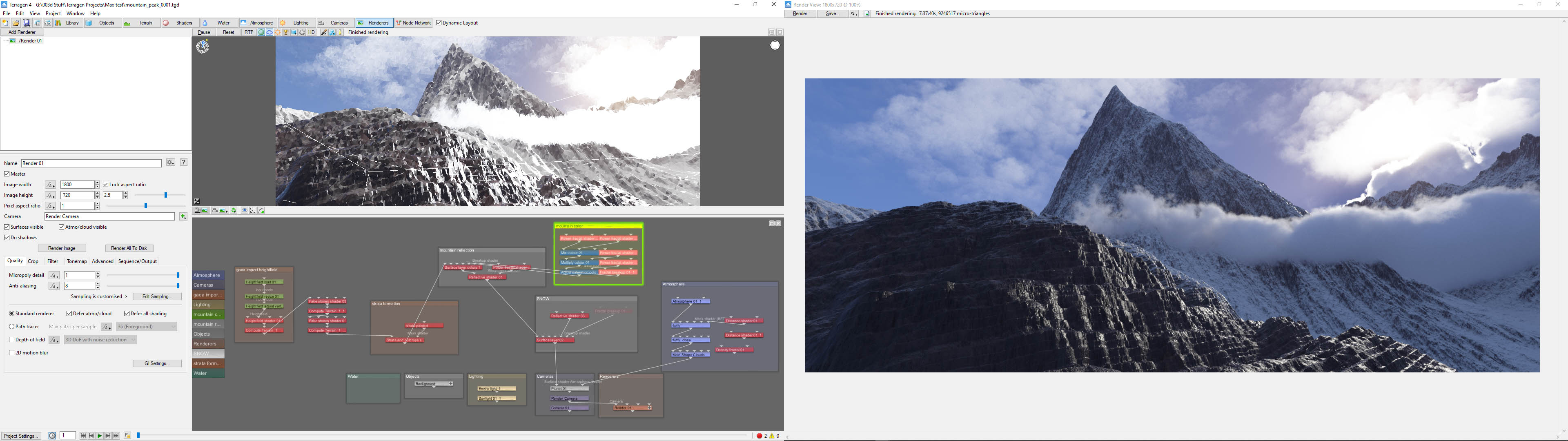

Here is a screengrab
i'll explain a bit but its mostly self explanatory
from left to right i created blocks and groups to handle the node editor better, first part is importing a Gaea heightmap and resizing it, is basically the huge peak in the middle of the image, after that i added some subtle fake stone shader on top of the geometry, just to break the look and make it uneven, after that i added a strata node which causes the rock to look like strata/outcrops, an adjusted the parameters for the look i wanted, i also masked it so it would affect just the foreground rock, thats pretty much it in terms of geometry, rest is shading, some reflection affecting only the forerground rock with a mask, a procedural color shader for the rock, some snow with reflection and the clouds under the Atmosphere group:)
Hope you like it, im loving it so much. sorry for big images [-x
