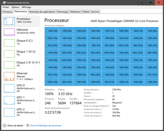

Any clue why is this happeing? Render not using all cores even i put fixed cores to 64 on settings....
Rendering image is 3200*1800 btw...

Render Cores used with Cycles for Softimage ;)
I often use between 400-600 AA samples and internal cycles denoising or FX Denoise (https://ssoftadd.github.io/fxDenoisePage.html)
Phil

Could you please try to render a big resouliton image at 3200 * 1800 a see what happens?
Post by wireframex » 30 Oct 2019, 18:29
With your rendering resolution I have more or less the same result as you.
Try to play with the tile size ...
Phil

Ah mon ami, i feel more tranquilo now. is this maybe some bug to fix i a new version? Thanks for trying for me 16x16 worked the best, but it still at 70% of CPU speed.
Posts: 258
Joined: 30 Dec 2016, 19:18
Post by Shekn » 31 Oct 2019, 13:16
It looks like a bug from original Cycles side. We can only hope that Cycles developers fix it (or it already fix in the current version). In any case, later I will update Sycles with the latest version of the Cycles.
