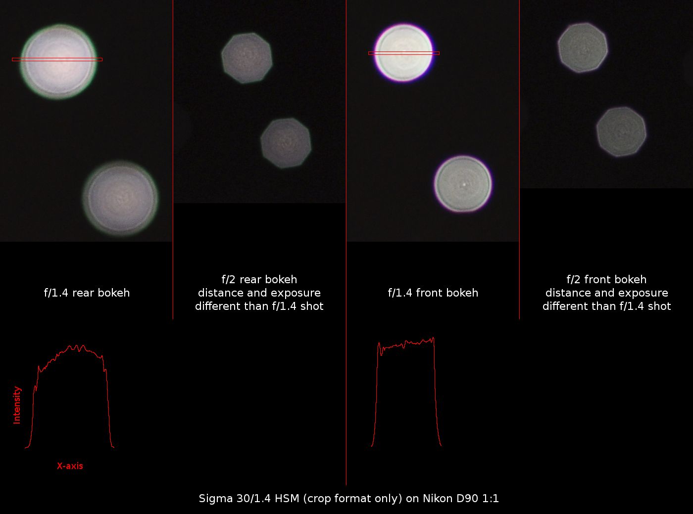

One question: I´ve seen some RS tutorials where they include a custom lens image for Bokeh effects. Is this a library that comes install with RS? If so: What´s the directory? If it´s a pack: Where to download? Thanks.
Posts: 1145
Joined: 19 Jun 2012, 19:59
Re: ehRSCamera for use with Redshift
Post by FXDude » 21 Feb 2019, 05:26
There use to be a link from a use on RS site, but now leads to nowhere.
But you can probably make a few different good ones from actual bokeh samples from this page (all about bokeh).
     http://jtra.cz/stuff/essays/bokeh/
