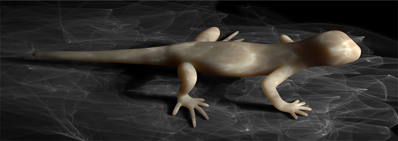

Looks so good I'm considering shaving my eyelashes :o)
Here's a test I did with photon (lit with caustics only)
