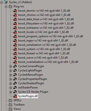

idk what is going on, first time i get this error while installing Scycles.
Anyone had the same? what could have caused it?
