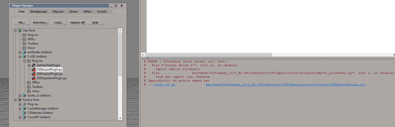

I tried to install the S-USD addons (on Softimage 2015b R2 SP2) , but not load. Maybe it's only for 2015?
Thanks a lot
Matteo

Post by Shekn » 24 Aug 2025, 04:34
Did you follow the instructions on this page: https://ssoftadd.github.io/usdPage.html ?
If yes, please show the Plugin Manager tree with the addon folder so we can determine which component failed to load.

Post by matevil » 24 Aug 2025, 09:16
Shekn wrote: 24 Aug 2025, 04:34 Did you follow the instructions on this page: https://ssoftadd.github.io/usdPage.html ?
Yes, I extract the libraries into my custom directory and create relative variables
Install the addon, and when I open or reload it, I have this
I can try to use a C:\Program Files\Autodesk\Softimage 2015\Application\python\Lib\site-packages\ and not the custom path ?

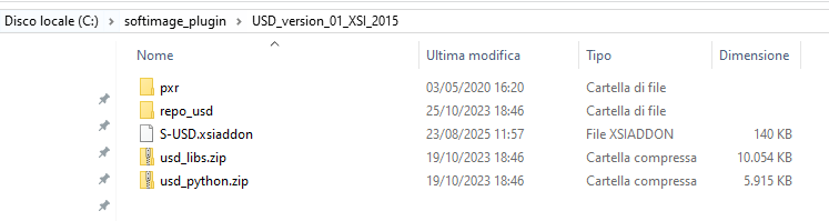

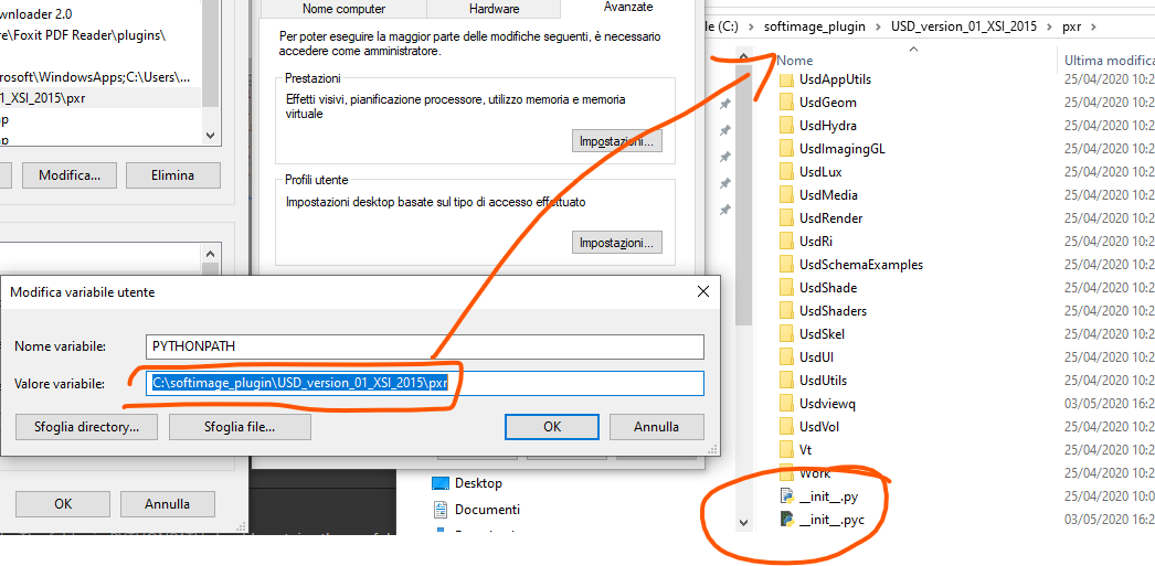

Post by Shekn » 24 Aug 2025, 16:02
It looks like the system does not see the path tp python module. The folder in PYTHONPATH should contains the pxr folder. For example, if there is a file: "F:\_Temp\s_usd\usd_python\pxr\__init__.py", then PYTHONPATH variable should contains the path: "F:\_Temp\s_usd\usd_python"

Post by matevil » 24 Aug 2025, 17:45
Shekn wrote: 24 Aug 2025, 16:02 It looks like the system does not see the path tp python module. The folder in PYTHONPATH should contains the pxr folder. For example, if there is a file: "F:\_Temp\s_usd\usd_python\pxr\__init__.py", then PYTHONPATH variable should contains the path: "F:\_Temp\s_usd\usd_python"
there is

Post by Shekn » 25 Aug 2025, 02:01
No, without pxr-part in the path. Simply C:\softimage_plugin\USD_version_01_XSI_2015

Post by matevil » 25 Aug 2025, 15:56
it's still doens't works... I try again

Post by matevil » 25 Aug 2025, 16:17
I fix it... I changed a path and variables (now it's under C:\Program Files\Autodesk\Softimage 2015_XXX\Application\python\Lib\site-packages\ directory) so... thanks a lot, now I can try the pipeline with Softimage+Houdini in USD
