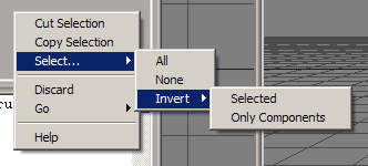

To create something that looks like this…
Custom Menu

Create an xPopMenu instance, add some items to it, provide callbacks for these items and call run(). Voila!
Check this code that creates the same structure you saw above. Please note that this code uses one of my stupid python tricks.
