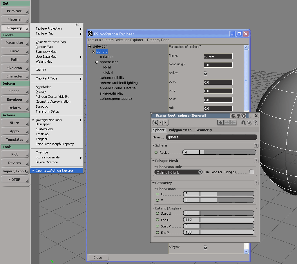

A look at the plugin!
In the Python XSI plugin called wxPythonXSIExplorer.py I implemented a really crude XSI Selection Explorer. This is an highly useless tool, but it shows how this is possible to nicely interact with XSI using a set of basic wxPython widgets. Please consider the explorer itself as a proof-of-concept tool!
wxPython in XSI
The interesting part of this plugin is the class called XSISubFrame. This is the class that implements all the gritty details described below, and I highly recommend you start your new wxPython XSI frame by looking at how I inherited from this class to create the XSIExplorerFrame. And how I use the XSISubFrame.create static factory method to create a new instance of the explorer.
I also implemented a SelectionChange event to detect the selection change in all the running instances of the wxPython XSI Explorer. Unfortunately there is no general hook for data change in XSI so if you move an object, the parameter value won’t update in our explorer.

The base trick to get a wxPython frame nicely displayed inside XSI, meaning on top of the XSI main window, but behind other XSI views when they have the focus, is to create the main frame as a child of the XSI top-level window. And for that we need to get its MS Window Handle.
The pywin32 package is here to help us: we can use it to list all the running windows and filter them by process ID, then pick the one which names begin with SOFTIMAGE. It sounds like a hack, but it’s just a small hack, believe me, MS Windows programming can get far more hacky than that!
The real magic happens when you use the AssociateHandle method on a dummy wxFrame so that wx believes that the XSI top level window is an actual wx window…
Then we just create our own sub frame using the wx.FRAME_FLOAT_ON_PARENT flag, which does what we want.
Then don’t forget to call DissociateHandle on your dummy frame, if not, XSI will not get some critical events anymore, like EVT_CLOSE, meaning you can’t close XSI anymore…
You will also need to do some cleanup when closing the wx window. The main problem is that wxWindow::Destroy does not destroy the top level window, it just waits for the
wxApp to destroy it on it’s next event loop. But as we don’t have a wx loop running, we need to destroy the top window by hand using the win32gui module again.
