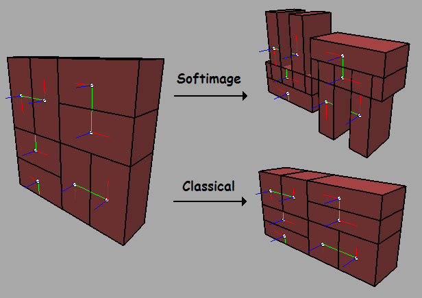

Most users won’t need to concern themselves with SI scaling versus classical scaling especially if they are doing everything in XSI and just outputting rendered frames. However, I would still like to give you a practical example of where you might want to use classical scaling instead of SI scaling. In the example below I have created a brick wall by translating and rotating individual (identical) bricks and parenting them under a null. Now, if I want to squish the entire wall by scaling the (null) parent I will get very different results depending on whether I am using SI or classical scaling. In this situation classical scaling is more useful since we do not want the bricks to scale along their local axes. (which point in different directions)
The good news is that, in XSI, you can mix and match SI scaling and classical scaling to fit your needs. Perhaps you are more comfortable with classical scaling because you cut your teeth on a different 3D software package.
First, if you want to make classical scaling the default in XSI, there is a preference to activate classical scaling globally under File > Preferences > General > Use Classical Scaling for Newly Created Objects.
If however you just want to use classical scaling on a few objects you simply need to 1) select all the objects in your hierarchy 2) hit Ctrl+K to inspect their local transforms and 3) turn off “Hierarchical (Softimage) Scaling” parameter. (which is found under the “Scaling” tab)
