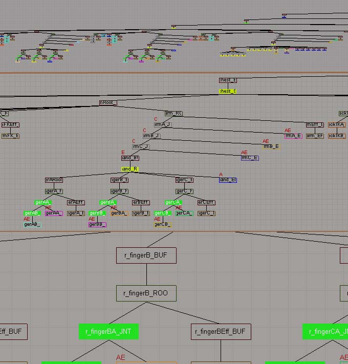

To explain a little bit what complexity we are dealing with, here’s a screenshot of some rig in the schematic view in different zooms:
A. Object templates
As you can see in the lower part of the image, there is naming convention applied to all objects in the hierarchy. The naming convention looks like this:
prefix_name_suffix
In this example the prefix can only be “m”, “l” or “r”, but it could be anything depending on your implementation. The suffix is used to determine the type of object we are dealing with, in the example the greenish objects have the “JNT” suffix, which stands for joint, a bone in a chain. Note that all objects have correct naming and the reason is that they have been created using templates. Here”s the idea:

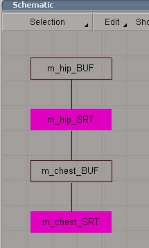

Simple enough, the example hierarchy looks like this:
