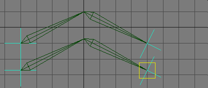

When an IK chain extends towards its full length, it will tend to snap into it’s final position. To prevent this from happening, it is possible to give the appearance that the IK chain is stiffening as it extends towards it’s full length. This technique isn’t new and similar functionality is already implemented in Cinema 4D.
In XSI, we need a way of allowing the chain to gradually fall behind the position of the effector. This stops the effector from snapping the chain into the final position, and gives rise to a much more natural motion (as seen below).
Soft IK Comparison

The snap effect visible in the top chain isn’t due to some inaccuracy in the IK calculation, but is just down to a simple geometrical effect. It can be shown mathematically (see diagram below) that as the effector pulls the chain into the final position, the velocity of the bones towards their final position tends towards infinity! This is obviously not desirable and can make the animation look jerky and artificial.

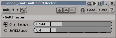

The soft effector object has a custom property to allow you to easily control the operator.
Soft Effector PPG
To make things easier for you, the Chain Length is calculated by an expression which sums the length of each bone in the chain. This allows you to change the length of a bone, and still have the Soft IK work.

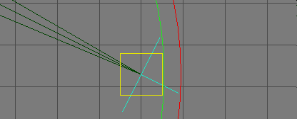

In the diagram below, the Soft Distance is represented by the distance between the green and the red lines (actually, they’re circles, but too large to see). As soon as the effector reaches the green line, our scripted operator starts to lag the chain effector behind our soft effector. This is done while making sure that we have no jerkiness in the motion of the chain effector.
Soft IK Closeup
