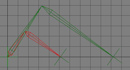

A diagram should make things a bit clearer. Basically, given a non-stretchy chain, we want to match the position of the two effectors by scaling the chain length, but without changing the bone angles, like this:
Scaling the Soft IK chain
Okay, so that doesn’t seem too hard. We just need to figure out how much to move the IK Effector to match the position of the soft effector.

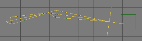

Scaling bone lengths
This diagram shows a bone chain with bones of different lengths, before and after I scaled each individual bone length by a factor of 2. It can be seen that the IK effector has traveled directly away from the IK root and has doubled it’s distance from it. Not only that, but the bone angles have remained unchanged. This is exactly what we need!
Now, all we need to do is to figure out the amount we need to scale each bone length to make the original IK effector match the position of the soft effector. That scale factor is just the ratio of the distances of the two effectors:
Scale Factor = EvalDistance(IK root, Soft Effector) / EvalDistance(IK root, original IK effector)
Where EvalDistance() is just a function that measure the distance between the two objects.

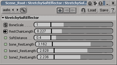

Stretchy Soft IK PPG
The bone lengths can be adjusted (and even animated) from this PPG, as well as the Soft Distance parameter, which behaves in exactly the same way as in the non-stretchy Soft IK. The bone lengths are all driven from this PPG using expressions. Note, that for extra performance we only have one Scripted Operator here which operates on the BoneScale parameter of the PPG.
