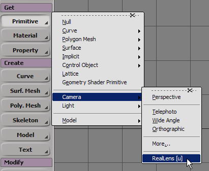

It’s a plugin that adds a menu item in Get -> Primitive -> Camera.
RealLens menu item

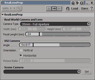

This opens a PPG.
RealLens PPG
It allows you to convert a real camera and lens angle to an XSI camera and vice versa. The most often used camera types are listed in a menu, with the “35mm Full Aperture” set as default since this is the one we use the most for film and commercial work. You can also choose “Custom Filmback” to set it to the values you want. You then enter a focal length and you obtain the equivalent XSI angle. If you change the XSI angle, the focal length will update automatically according to the camera type.
When everything is ready, you can select a scene camera and hit the “Set” button. This will set the angle of view and the picture ratio for that given camera.
