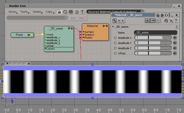

The starting point is noticing that the node that more resembles the sine and cosine look is the Wave one. By connecting it straight to the surface and setting the parameters as shown, you have something really looking like a cosine function.
Wave shader

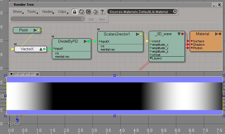

To enlarge the wave period to match the cosine’s, we simply need to devide the input by 2*PI.
Cosine Shader
Now we can push everything into a single phenomenon, having just one input parameter (the cosine argument).
This is the connection section:

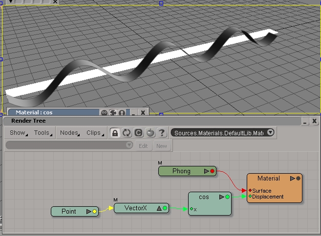

Connection root = "sib_color_to_scalar";
Cosine shader used as displacement

You can download the two spdl’s from here.
