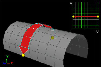

However, most of the time, the object to be covered is a polygon mesh, so the situation is a bit more complicated, we have to recreate the UV space somehow.
A solution could be to group polygons in rectangular clusters and automatically generate an unwrapped UV map for each cluster.
By doing this it is possible to treat a poly mesh as a parametric surface, but we cannot rely anymore on XSI’s internal UV-to-XYZ function, we have to make our own.

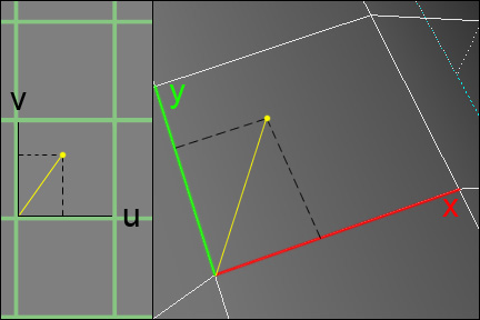

This function will use two edges of a polygon to define a local cords system XY, once a point is located in the polygon’s local UV it is just a matter of tracing the same vector in XY space, maybe the image bellow explains it better.

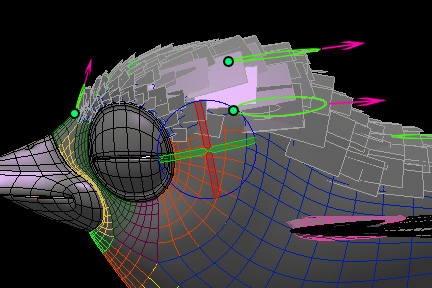

If the goal is to orient many objects with the minimum amount of work for the final user, then a solution is to control those objects with a small number of sub-controls.
The orientation and the scale of each feather is in fact the result of the interpolation between several control objects, lets call them “control-feathers”, with just a few of them it is possible to orient thousands of elements, even over time which means animated feathers!
Such an interpolation is based on the distance of a feather to its control-feathers, the nearer a feather is to its control the more alike is the feather’s orientation.
The unwrapped UV space used for instancing feathers along the mesh is perfect for calculating the distance between two points, even if the surface is curved as a cylinder, that in the case of a bird is pretty much a good approximation of our target mesh.

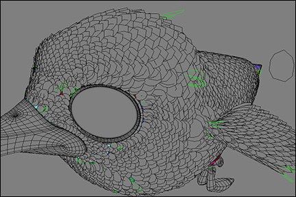

It is possible to get rid of the UV approach by sacrificing just a bit of control over the feathers’ distribution and bit of precision for the distance calculation between feathers and control-feathers.
In short, the instantiation process would be done on a per-polygon basis by virtually subdividing each polygon for a user defined N number of times, a weight map could scale in proportion this N value to give better control over the density.
To calculate the distance of a feather to its control-feathers we have to get rid of those controls that are too far and on the opposite side of the mesh.
For each feather we have to find the distance to each control-feather and set a tolerance range so that only those controls inside that range will be used for the interpolation, but still those controls on the opposite side of the mesh could be inside our tolerance range, so to get rid of them we have to play a bit around with the dot product and see what’s the angle between the feather and the controls, at this point we can interpolate even without the UV space being sure that only the right controls are going to be used.
