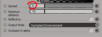

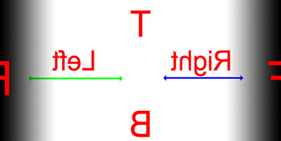

As the map will be used by the environment shader, it will, by default, be wrapped on an infinite sphere around the scene. We will paint in a 2D UV space. To precisely paint our “lights” on the map we need to know where we are. Use the picture below as an environment map and set the “Spread” parameter to 0 in your occlusion shader to find your way.
Map with markers
Shader at 0 spread
The Black to white gradient is the seam where the left and the right stick together. It is aligned with the Z axis. If we need a light with a position equal to 0 on the Z axis we must paint half a light on each side of the seam. In the video capture at the end of this article I will show how to deal with this particular position with a bunch of FXtree nodes. The other way is to rotate the spherical projection on the Y axis in the environment shader to avoid a sun light in the side of the map.
You will see the non blured picture like bellow.
Environment from outside

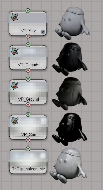

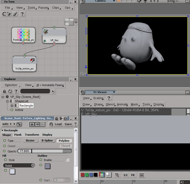

By default the map used in your environment shader is the noIcon pic, you can get it in the FXtree from the clip menu. Then add a vector paint node and set its size to 128 by 64 pixels. The smaller the environment map is, the faster the render will be. Plug the vector node in the “ToClip_noIcon_pic” input. Now you can start to paint the sky for example. Keep a render region and an FX viewer open at the same time to see how your painted lights behave on the 3D objects.
XSI Layout example
Now all you need is to add one vector paint node by shape . You could use only one vector paint but in this case you couldn’t change the order of the shapes. The interesting thing is that you will often use large white ellipsoid shape and it won’t be longer to render when compared to area lights.
You can add as many nodes as you need, it won”t change the render time.
PBL setup
