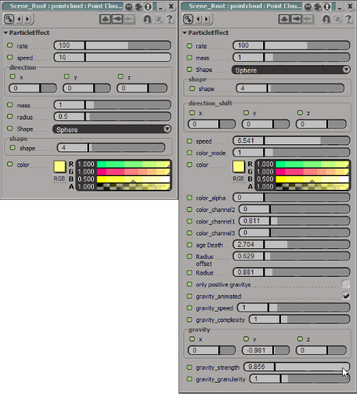

Also, all parameters affecting the simulation should reside in the same property page. With a typical ICE tree containing easily 20 compounds or more, finding a parameter often requires a search through many compounds. Too many doubles clicks are required to access the compounds’ parameters; why not put them in one location. When a scalar is randomized for example, the parameters associated with randomization should replace the original scalar in the top property page. You say: isn’t the top compound intended for that? Yes, but it doesn’t expose ports automatically. Remember, the goal here is to create particle simulations in a production environment; not to design ICE trees in a R&D context.

In the following video, I demonstrate a working prototype. It shows the above ideas in action with the exception of having iterations made through parameter contextual menus instead of the plug connection icon menu. The Softimage development kit does not give access to this type of UI widgets for ICE compounds property pages. Also, for clarity’s sake, it would have been beneficial to have used tabs in the property page to seperate emission, particle type, forces, triggers and events. This was not implemented. This prototype was written about a year and a half ago with a beta version of XSI 7.0 and unfortunately has not been updated to work with the current version of Softimage but would be relatively simple to rewrite. I must also credit my colleagues at the time, Jeff Wilson, who helped with the original concept and Javier von der Pahlen who co-wrote the prototype. It is important also to say that I was an employee of Softimage at the time when that prototype was written. As a long time user of Softimage’s products, I was trying to push solutions that made the work of technical directors easier. Unfortunately, this concept was not accepted. But it remains a great concept on how technical directors can go beyond compounds and integrate ICE in production pipelines more efficiently. It clearly illustrate the ability to build a simple particle animation rapidly without having to access the ICE tree. All iterations are made through the property page.
