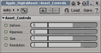

In the end, I put in four controls.
Asset PPG Controls
The Deform parameter drives the amplitude of a push operator connected to a weight map to add variation to the shape of the apple. Since I didn’t lock the weightmap, you can still modify it using the weight paint brush to change the shape.
The Ripeness parameter drives an expression to control the color in the render tree (you need to render the apple to see the color change). Note that I had to use a “Vector Share” via a “Vector To Color” to drive the diffuse color, as XSI doesn’t let you put expressions on color parameters.
The Size parameter uses some basic rigging to change the size of the apple without changing the size of the stalk.
And finally, the Resolution parameter directly drives the Geometry Approximation to alter the subdivision level.
