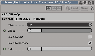

Here is the main tab of PB_Jitter:
The main tab for PB_Jitter
This generator has two facets to it. A sine wave generator and a random noise generator.

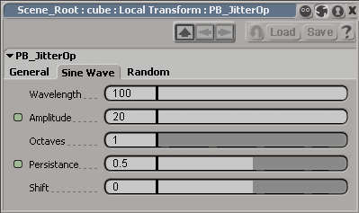

The first part of the generator creates a sine wave. This regular motion can be toggled on or off, it’s amplitude can be animated and the base wave can be shifted left or right. A concept of octaves is also available. Each successive octave’s computed value is added to the total value for that calculation but each octave’s wavelength is half the preceding octave’s and each successive octave’s amplitude is diminished by a factor corresponding to the overall persistance. This means that the higher your persistance and the larger the number of octaves the wilder your motion, while the lower the persistance and the lower the number of octaves the smoother the motion.
The sine tab of PB_Jitter

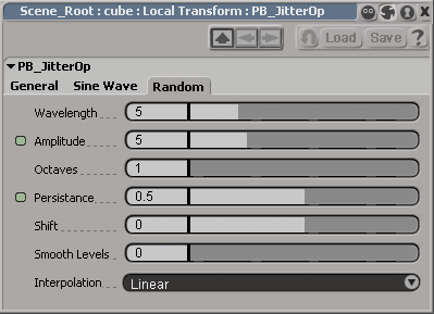

The second part of the generator creates random noise. The wavelength of this noise is animateable as well as it’s amplitude. The octaves/persistance concepts show up again like in the sine wave generator. This time around the extra features you get are a choice of curve interpolation and a smoothing option. The horizontal shift this time can be used as such or it can be used as a random seed by inputing ridiculous numbers and shifting the curve left by, say, -2845037.
The random tab of PB_Jitter
