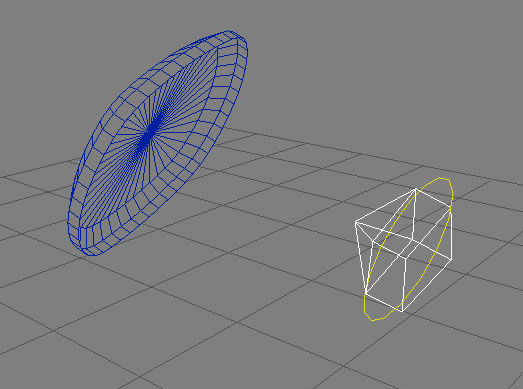

In this post I would like to demonstrate a technique using a scripted operator to roll something along its edges / boundary. The post includes the full code as well as images / movies for further explanation.
I created an object, and extracted a curve from the boundary edges. Of course, you can always go the other route and create the curve first, and then afterwards create the mesh off the curve.
What I now want to do is roll the object along this curve, like a footroll. Here’s a picture and a movie for further explanation:
The movie is encoded using Camtasia (Techsmith Codec) and is around 3 MB small / large… ;-) Click on this link to get it.
The code is fairly simple, and I tried to comment / document as much as possible.

If you want to checkout the scene, here it is (XSI 5.1).
You can find the scripted operator below the local kinematics of the curve. Enjoy!
