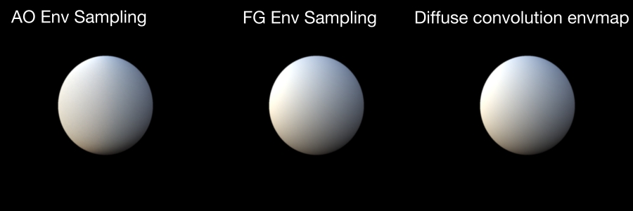

Render Balls simple test.
Env sampling brute vs FG vs Diffuse Conv
The way I set up the scene is very simple. I tried to get the contribution of the envmap once convolved and only this. So there is no illumination model just different approach.
The HDR used for this test the one called beach.hdr that you can find at debevec’s website. The map that you download is an angular map so you have to convert it to spherical coordinate system. The easiest way is to HDRshop and convert to angular map to longitute/latitude map. Once the map ready, I put it in my scene as an environement map.
The first sphere is the result of an AO shader set to environement sampling mode with a spread of 0.8. I had to crank up the sampling to 1024 to get a smooth solution. AO env sampling is brute force approach. There is no importance sampling so that mean you have cast a lot of ray to get a smooth result specially with high dynamic range image. And obviously that be very slow. It’s the slowest render.
With the second sphere I used to FG to sample env. Same settings as before except that I use a shader that return irradiance and activate FG. FG is a lot faster that the previous method because it doesn’t sample every point with 1024 rays. Instead FG will sample a certain amount of point and interpolate the result between the point calculated. But for this comparaison I pushed the number of rays to 4096 to make sure I got enough accuracy to have fair comparaison with the quality of the next approach. Even by pushing the number of rays to 4096, it was still faster to render with FG.
With last sphere I made a diffuse convolution in HDRshop ( using the SH_diffuse plug in because it ‘s a lot faster than HDRshop’s function), applied the resulting image as an environement map and use the XSI’s AO shader with the sampling set to 1 and the spread to 0.01.
The render time is ultra fast and match FG solution. It ‘s actually realtime because the convolution has been already calculated once in HDRshop.

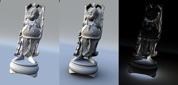

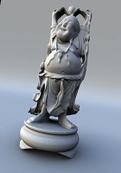

I like buddha. I like him because it’s a one million polygon model that can be compared to any displaced model push out from Zbrush or Mudbox.
I have simply applied what I did with the spheres.
The first render is with an diffuse convolved envmap. It took approximately 50 sec to render with a large part of preprocessing the scene. If I had a realtime shader could get the same result ( minus anti aliasing ) in realtime. Obviously there is no occlusion calculated but that due to fact I asked only an environment lookup around the normal of the surface.
The second image is what you get if you were using FG and third one is a difference done in shake
to highlights the difference between the two renders.
As you can see only the occlusion and the FG colored bounce are missing. If you apply a simple occlusion on the top you will endup with an image that is fairly close to the FG solution but with only a fraction of the time involved by the process.
