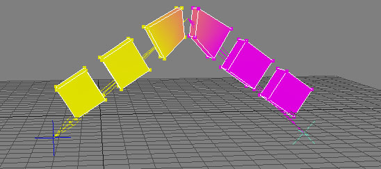

Lets start. One easy way to approach this problem is to create a mesh including all objects we want to envelope, and then simply set the envelope weights of all points of a single instance to the exact same weight, aka:

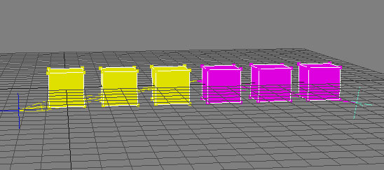

In this image we have a mesh with 6 cubes (all merged together) enveloped to a two-bone chain.
By default the weight is blended in the middle part,
which results in a deform for the middle two cubes:

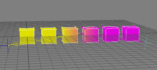

by using the weight editor, I adjusted the weight of all cubes so they only target one bone:
which results in movement, but not deformation for each one:

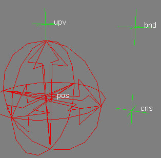

When instancing an object, all you need is a position, orientation and scaling, which can be stored as three points really, but in this example I am going to use 4 points:
1. Pos: The position of the object to be instanced
2. Cns: The Z-Direction of the object (seen from pos)
3. Upv: The Y-Direction of the object (seen from pos)
4. Bnd: An additional point to be used for deformation (later)

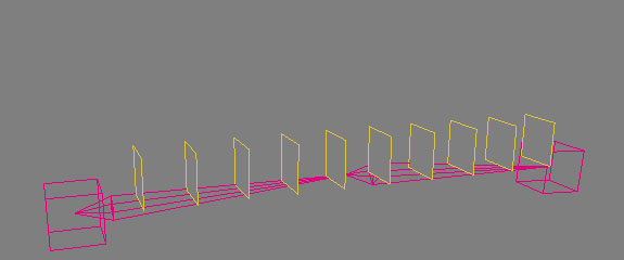

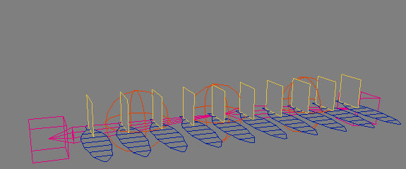

So basically we could draw a quadrangular polygon instead of four points, like below, where we are instancing ten grids:
Now: Instead of enveloping the objects we want to be instanced, we envelope the mesh containing the quads. This is going to be called our “Instancing-Cloud”. It contains all of the information we need to instance our objects. Moreover, it is easy to envelope, as we know exactly which points are to be enveloped where. Every first out of four points is the position, every second out of four points is the z-direction etc… All we need to build is a couple of scripts:

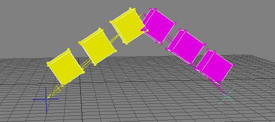

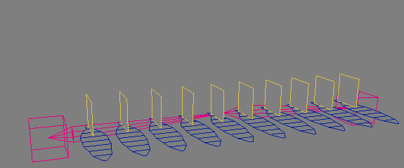

A finished setup could look something like this: We see the quads representing the instances:

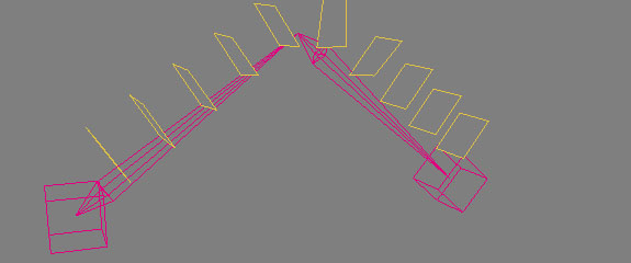

When deformed: The quads deform, but the instances will not:

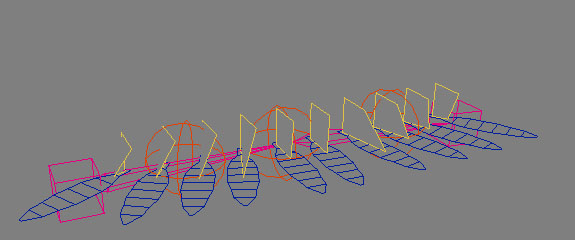

Including the instances it should look like this:

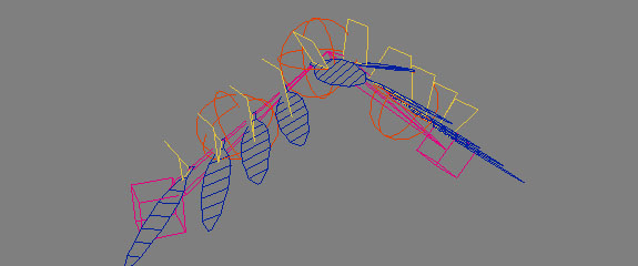

When deformed:

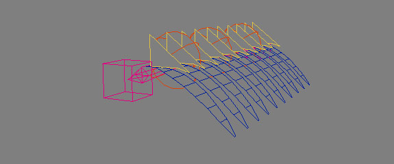

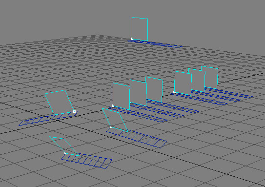

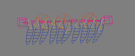

As we have point clusters for each type of point in the instance-cloud (pos, cns, upv and bnd) it is quite simple to rig the cns for example to a bunch of rotational controllers:
And when we rotate them, only the cns points are deformed, therefore the instances rotate as well:
Additionally we can deform the cloud overall:
So now lets discuss the last part of the story: What’s the bnd position for?

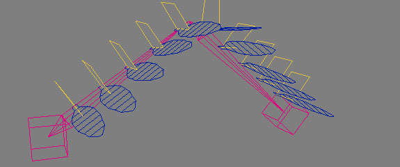

The bnd position is used for deformation of each instance. As this is quite limited, all I am going to do is move the instances points using a sinus function, to get somewhat of twisting and bending going on. This is up to your imagination, as I said, this setup has been used for feathers, that’s why the bnd position is used for bending (and named like that as well: bnd = bending).
In the next image I rigged the bnd position to the rotational controller earlier used for cns, to show what happens:
So now when I rotate them:
Or along another axis:
