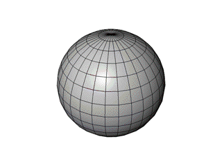

Here’s an animated gif from the webpage above, demonstrating the functionality. We are focusing on the part with the red circle.
Looking the animated gif, I can see the following steps to reach our goal:
  • Get a polygonmesh and a curve
  • Put the curve onto the surface of the mesh
  • Delete all polygons “below” the curve’s shape
  • Extrude the resulting new boundary to fit the curve

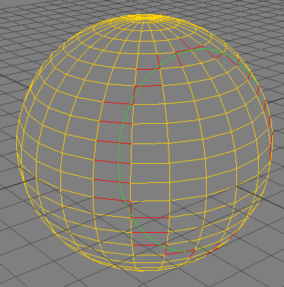

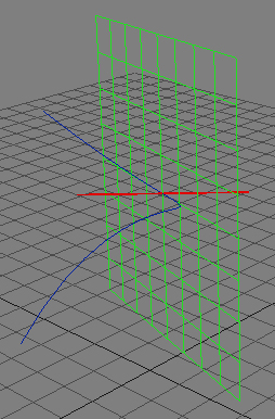

I need a function to figure out if an edge crosses a curve. This seems to be a hard one, it’s not really though. Let’s look at it:
To find out if an edge is crossing a curve, we need to find out if the two points of the edge are on the “opposite” sides of the curve. If they are, the edge crosses the curve. To do that, I will find the closest points on the curve for the two edge-points, find their center, and the center’s point on the curve. Then I take the tangent of the curve at this position and build a plane which cuts the edge in 3D, or not. If it cuts the edge, it crosses the curve.
In the illustration, the blue line is the curve, the green grid marks the plane used for the intersection calculation and the red line is an example edge.
And here’s the javascript function:

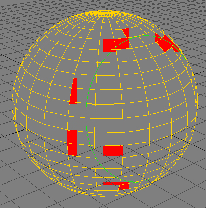

// returns an array of indices of the edge crossing the curve
function js_getAllCrossingEdges(meshObj,curveObj)
	// define an array for all of the edges crossing the curve
	var result = new Array();
	// get the geometry of both objects
	var mesh = meshObj.ActivePrimitive.Geometry;
	var curve = curveObj.ActivePrimitive.Geometry;
	// loop through
	for(var i=0;i<mesh .edges.count;i++)
		// get the edge
		var edge = mesh.edges(i);
		// if it crosses, put in the result array
		if(js_doesEdgeCrossCurve(edge,curve))
			result[result.length] = i;
	return result;
Result:

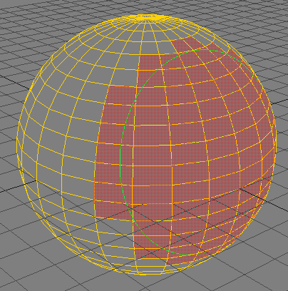

Now as we have all edges crossing the curve, we need to find all of the adjacent polygons. As adjacency is a simple task, I am not going to use XSI’s command for selecting adjacent components, but implement a JScript function to do the job. It is simply looping over all edges and finding all polygons adjacent to each edge.

// gets all adjacent polygons of an edge-index-array
function js_getAdjacentPolygons(meshObj,indices)
	// get the geometry of the meshObj
	// an array which is used as a hash-table
	// for all of the polyons used
	// example: if polyUsed[4] == true, that means
	// the polygon with the index 4 is adjacent
	var polyUsed = new Array();
	// loop through all edge indices
	for(var i=0;i<indices .length;i++)
		// get the edge
		var edge = mesh.edges(indices[i]);
		// get the collection of neighborpolygons of this edge
		// note: an edge can have only one polygon linked to it
		// that means it is a boundary edge... if that happens,
		// just return false to tell the calling function that
		// we have to stop now.
		var nbPolies = edge.NeighborPolygons();
		if(nbPolies.count&lt;2)
			logmessage("We cannot cut a boundary!");
			return false;
		for(var j=0;j<nbPolies.count;j++)
			polyUsed[nbPolies(j).index] = true;
	// define the result array
	for(var index in polyUsed)
		result[result.length] = index;
	return result;
Result:

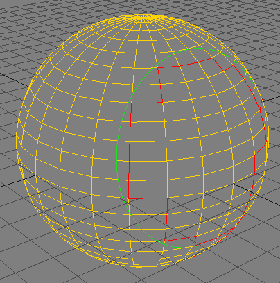

To find the two boundaries and determine which one is shorter, I loop through all edges of the polygons I just got from the adjacency function and count their occurences. If I find an edge which is used only once, it is a boundary of the polygon-island. To find the two different boundaries, I start with one edge, mark it as non-boundary and find the next connected edge which is a boundary. I repeat that step until I reach the edge I started with. Those edges all together are one boundary (either the inner or the outer one – I don’t know that yet). Now I can just take all of the edges and define them as “the other” boundary. By comparing the number of elements in both boundaries, I can find the shorter one and define it as “the inner boundary”.
First – I need a function which tells me if two edges are connected or not:

Second – I need a function which does what I described above: Find the shorter (inner boundary) and its elements:

// returns the shortest edge boundary of a given polygon index array

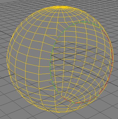

Result:
Now we have the polygons crossing the curve and the inner boundary. Another function will now get all polygons to be deleted. It basically does a “grow selection”, but with the following rule: We can only grow the selection over edges which are on the inner boundary. That way we get all polygons “inside” the boundary – not the ones outside of the polygons crossing the curve.

Result:
4. Move the resulting new points onto the curve

Result:
