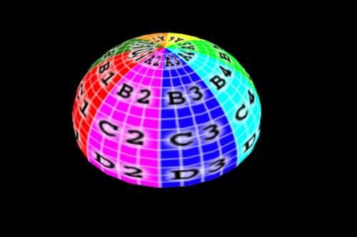

This the starting case (a phong sphere – top), and our first result (bottom)

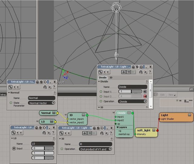

And this is the rendertree for the light
Also in light shaders, the normal can be used (it’s the lit point normal). The dot product of the normal with the light direction L0 is the incidence, which we then use to divide 1, and return the result as the intensity of the light.

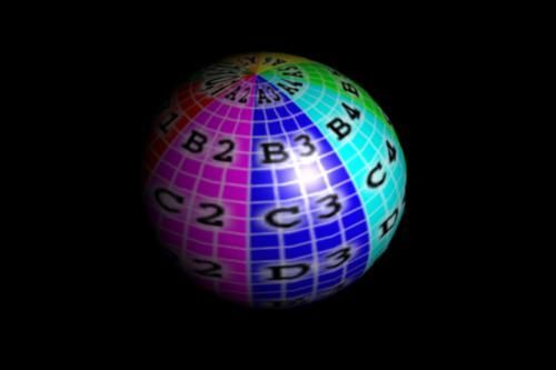

That was ok for a half dome, but what about the rest? A possibility is simply to double the light, specularly to the xz plane, cloning the rendertree (and L0 becoming 0,-1,0 for the other light). That would cover 99% of the cases, being any oriented surface sample being lit only by one of the two lights at most.
The “at most” is the remaining problem. If you have a cube, its vertical faces won’t be lit by any!

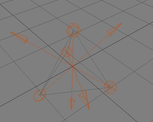

So, we have to expand a bit this setup. We start setting up a minimal light rig, ensuring that al least one of the lights will always hit any oriented surface. The minimum number of lights for such a rig is 4, equally distributed in space.
So, we take a tetrahedron of radius 1, centered at the origin, and cluster constrain a directional white light to each vertex, all pointing toward the origin.
Each light has the following rendertree (with a small change for each of them)

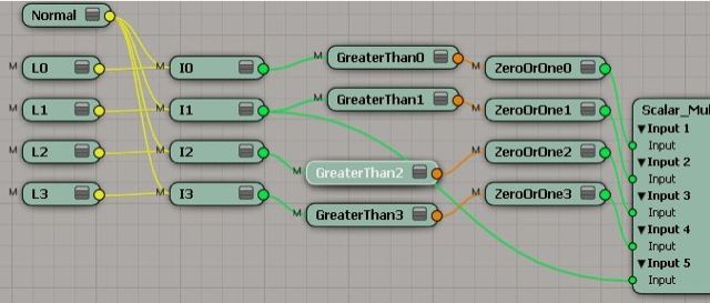

This is the tree for light L0: the left side vectors are the four lights positions, set by expression. Since The tetrahedron has radius one, they also represent the direction toward each lights. All their incidence with the normal is computed and sent to a positivity check, and this check drives a switcher between zero and one. So, the sum of these 4 switchers is the number of lights (1 to 3) visible from the rendered point.
This number is multiplied by the light incidence and the result divides 1, as in the single light case.

The other 3 lights have the same rendertree, except the dividing incidence comes from I1, I2, I3 respectively. For instance, this is the tree for light L1.
