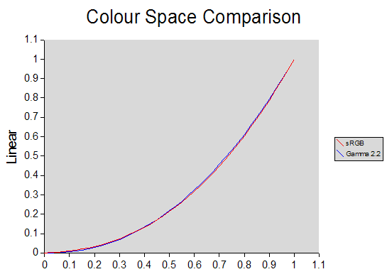

The Gamma Function As An Approximation
As can be seen by the above graph, the sRGB standard is very close to the gamma 2.2 curve. For this reason, the full sRGB conversion function is often approximated with the much simpler gamma function.
Please note that the value associated with the word gamma is the power value used in the function y = xp. Unfortunately gamma is often associated with brightness, which is not exactly what it is doing. The full [0, 1] interval is always mapped back onto the full [0, 1] interval.

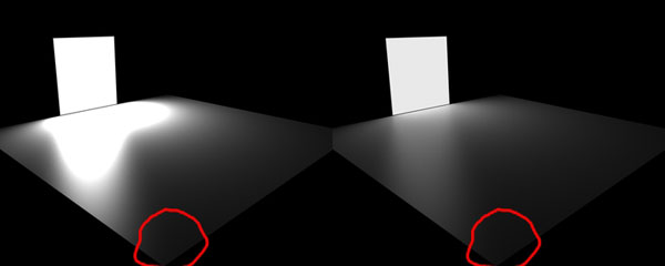

My first example is simple. A grid with a phong shader and a light. An area light with a realistic falloff. To do this I am using the D2S_light with a temperature of 6500 K (White). I set the light intensity to get the same result in the red area.
The left picture is rendered as-is in XSI while the other one is rendered with Lin_to_sRGB Lens shader. As you can see the left picture is overlighted. (intensity around 4000) While the right one behave nicely (with an intensity of 750 only).
Note that even the specular from phong shader looks correct. It looks like the reflection of the area light.

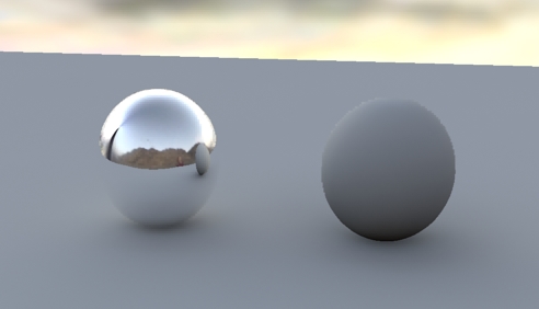

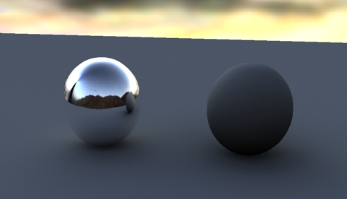

My second example is a simple FG scene with 2 spheres and a plane. The plane and one of the sphere got a DGS shader with only a diffuse term set to a neutral gray. The second sphere is fully reflective to see the environment map.
I used an HDR image from Paul Debevec’s website called beach.hdr to light my scene with Final Gathering.
The first test is a render as-is:
As you can see the color of the environement map are more contrast / darker than what we can see in HDR shop. To correct this naturally we will change the exposure but the color will be affected and we will got a more saturated image which is wrong.
If we use the lens shader we go this result:
The result this time is what we expected. The color match to what we can see in HDR shop. We can start to work safely because we got the right illumination.

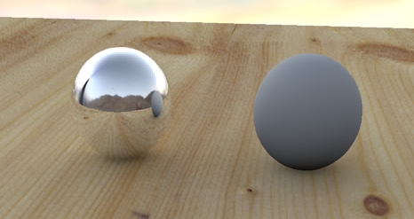

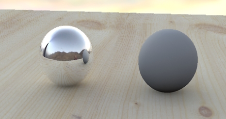

On my next example I am introducing a texture on the grey plane by plug to the diffuse slot an image node. I am keeping the same HDR illumination and the lens shader.
As you can see the texture is washed out. This doesn’t come from illumination. This wood texture has been generated in sRGB color space. With the lens shader we simply apply an another time the sRGB convertion. What we need is to convert this texture in linear space before the render. It is the purpose of the sRGB_to_Lin texture node. Just plug it between your image node and the diffuse slot and re-render.
As you can see now our texture is corrected and looks natural.
