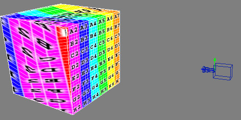

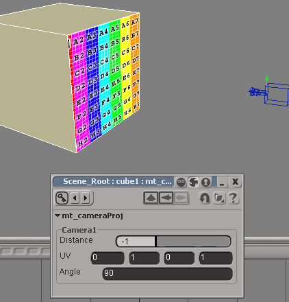

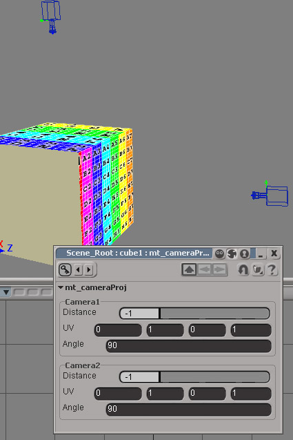

The image above shows a default cube with a camera projection applied. As said before, you cannot limit the effect based on angle or distance. The method I propose supports both, as well as multiple camera.

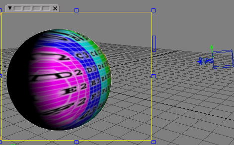

In this example I am using one camera, and limit the camera projection effect to an angle, so that only polygons facing the camera will get the camera space UVs.
Another way of working with this projection, is to use multiple cameras driving one uv projection. This can be extremely helpful for image based modeling, as well as projection of multiple images when dealing with panoramas. You can limit the output of each camera in U and V, so that you can use stripe images, or cross images for example.
To apply the projection, just select the mesh and at least one camera (you can select up to eight cameras), and click the “camera projection” button on the ‘mt_camera_proj” toolbar provided with the addon.

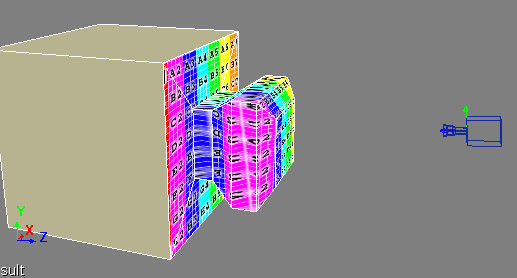

This image shows the distance based limiter in action. Basically, the angle isn’t limited, so all polygon receive UVs, but the distance of the projection is set to 8, so that only polygons in that distance are projected.

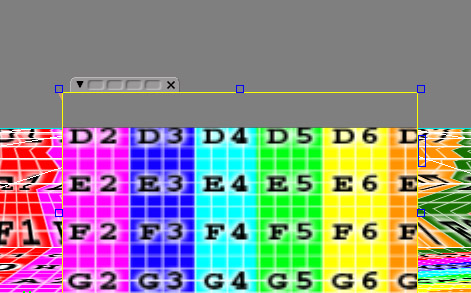

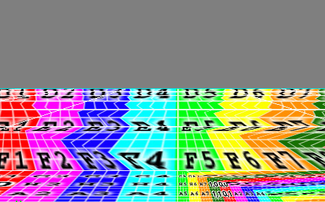

So far so good. We still end up with the strechtes though. This is due to triangulation and UV interpolation. There is also no difference in mental ray vs. real time rendering. The problems always show up.

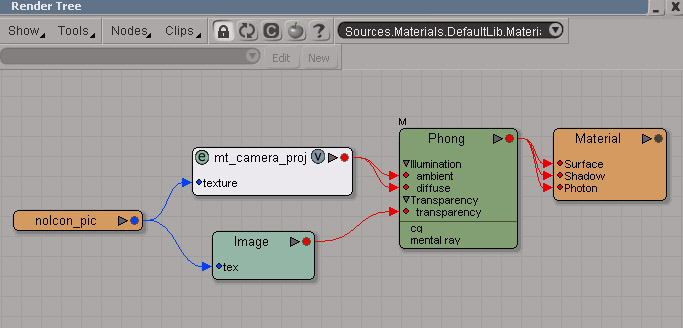

To get around this, the only way to improve accuracy while maintaining the same projection, is to add a shader, which will do the calculations all over again, without using the existing UVs. What’s really nice about this is, that the shader doesn’t actually require UVs, which makes it possible it to apply to groups, layers or even partitions for pass rendering.

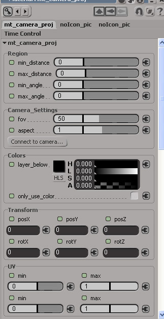

Here’s a rendertree showing the new shader in action. It requires an image, and outputs color.
To enable multiple cameras for this use, the shader has all of the camera settings necessary, including field of view, aspect ratio, a position and rotation. Moreover, you can link all of the eight parameters to an existing camera by clicking the “Connect To Camera” button, and then pick a camera in the explorer.
Furthermore there are settings for limits based on angle and distance, this time with a min and max, because, as we are looking at a shader, we can do smooth blends now. The parameter “layer_below” is used for the areas not covered by the projection, respectively for blending. This enables you to use multiple camera projections in a row, by plugging the previous one into the next one’s “layer_below” port.

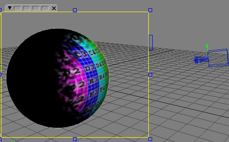

This image shows a camera projection render with angle based blending turned on.
As we have all parameters of the shader as pluggable ports, you can use other shaders to drive parameters such as the angle limits for example. (pretty wild.. huh!)

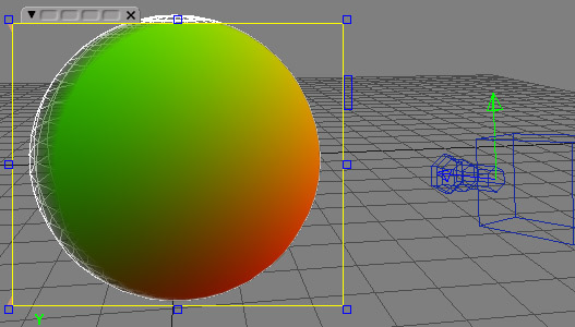

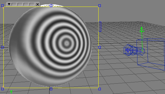

Also, if you don’t want to camera-project an image, but a procedural shader, you can turn the “only_use_color” parameter on. In this mode the shader never pulls the texture, but outputs the calculated UV coordinates as a RGB encoded color.
You can then use this color (after beeing converted to a vector) to drive any other texture generator (a ripple in this case). This makes it possible to camera project procedural textures at render time, without any UVs.

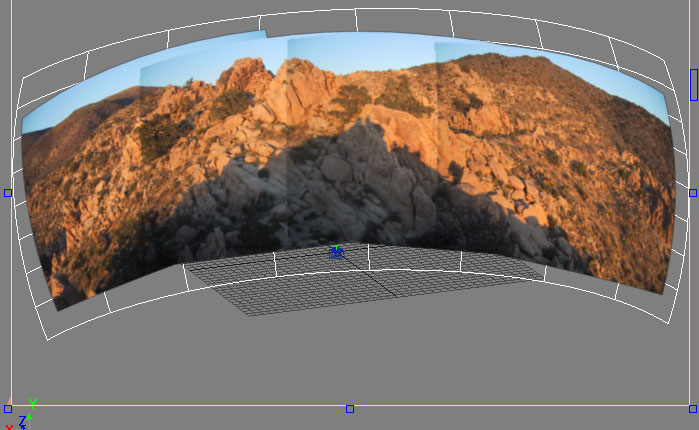

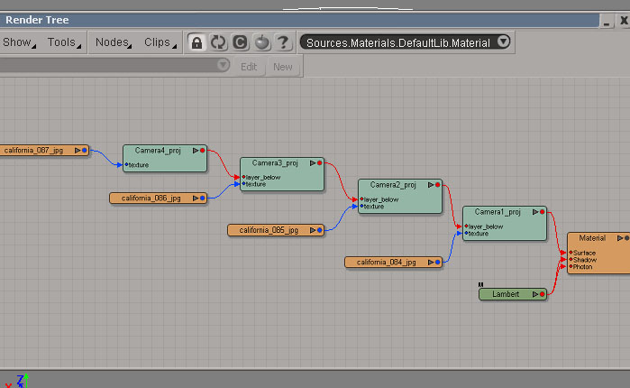

This is applicable as well to panorama images, by overlaying multiple images….

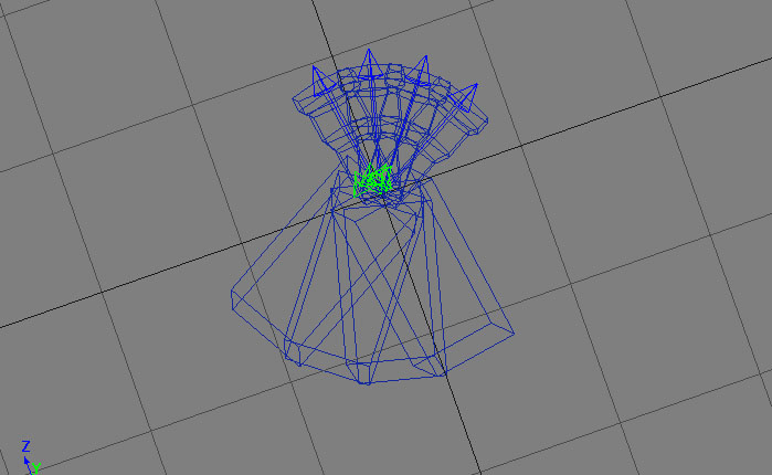

so if you use a couple of cameras:
a shader setup like this:

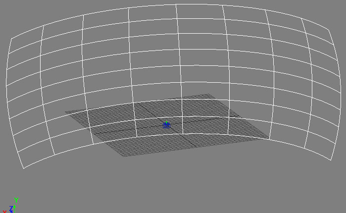

you can turn a spherical geometry like this:
into a panorama like this (using 4 photographs):
