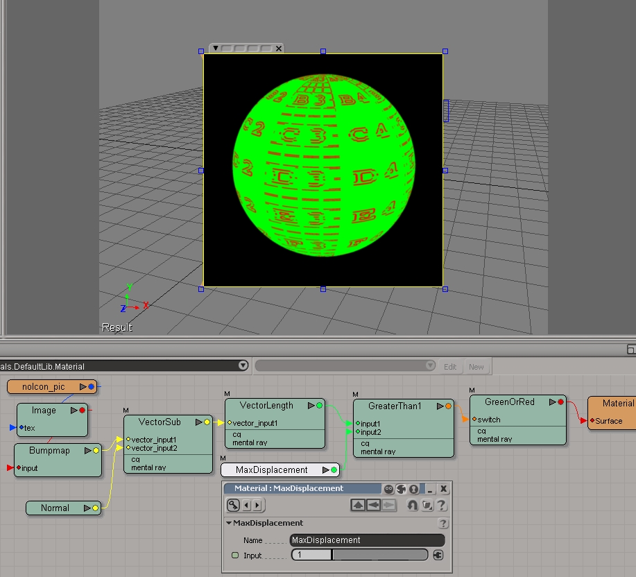

In this first rendertree, we simply want to check the “dangerous” zones. We take the length (L) of the normal’s difference (D) and check it against a maximum scalar. If this scalar is exceeded red is returned or green otherwise.
In this example the scalar is set to 1, we are seeing in red the parts where the bending angle exceeds 60 degrees.

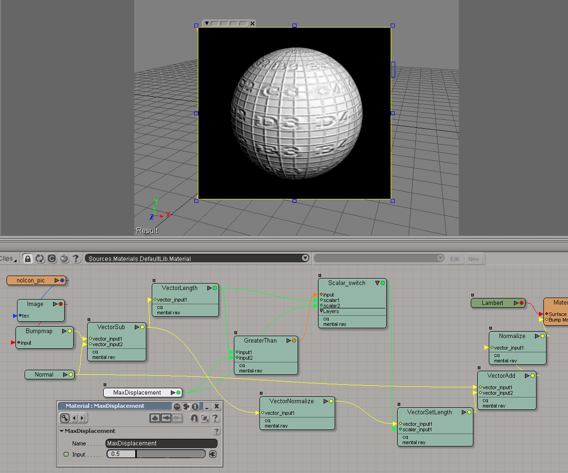

To output the filtered normal, we do the same test as above, but connected to a scalar switch.
The switcher outputs the maximum between Max Displacement and L. This value is used to set the new length of D (VectorNormalize + VectorSetLength).
This vector is then added to the original normal N and normalized. This is our new, filtered normal.
Of course this is a very basic filter, more complex ones can easily be built to fit your needs.
You can grab the scene if you want. The red and green subtree is also included, connected to the shadow port.
