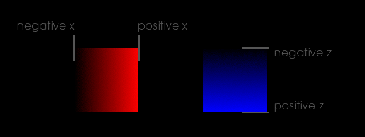

In Photoshop, you can very easily create such a vector map. All you need to do is to make two grayscale gradients. One is from right to left in the red channel of the image and the other is from bottom to top in the blue channel. Make sure your gradients are linear and not cubic (smoothness 0 vs smoothness 100).
Vector Colors
These colors will then be interpreted by XSI so that the full red color will point to the positive x direction and black will be pointing to the negative x direction, pos z and neg z respectively for the blue color. To do this the color channels must be split apart and remapped to a vector. By using Pick_Channel and Change_Range nodes you can easily remap color values (0 -> 255) to a vector component (-1, 1). After having done this for both red and blue channels of your picture, you can recombine the scalars into a direction vector by using a Scalars2Vector node.

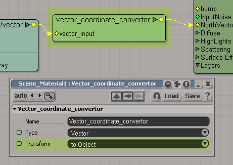

One last thing to note is that even if your texture is applied locally on the object, the vector that is built with the texture’s values is defined in world space. To get proper anisotropy that will follow your object’s every transform you need to convert the vector to object space by using a Vector_Coordinate_Convertor node. Switch the Transform to to Object.
