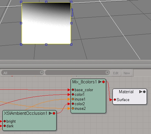

In our XSI rendertree, we basically need to distinguish the three scenarios.
This picture shows how to find out if the occlusion output is equal to bright_color or dark_color. The two colors are subtracted from the output, and if the absolute value of the difference is smaller than a threshold (~0.01) then one of the two rightmost nodes will output true.
In order to switch between three colors, we take a Mix_8colors node, set the weights to white, and allow:
Case 1: bright_color, because IsBright==true, IsDark==false, BothFalse==false
Case 2: dark_color, because IsBright==false, IsDark==true, BothFalse==false
Case 3: a better occlusion, because IsBright==false, IsDark==false, BothFalse==true
With “better occlusion” we mean a clone of the previous occlusion shader, with a much better sampling rate.
Note that we’re not considering the case where bright_color == dark_color, which is a possible case if you are texturing the occlusion inputs.
This is the full rendertree (get the preset here)

We can fix the problem filtering off the brightness through a linear gradient node, as shown in the picture.
