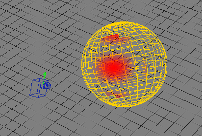

Here is what the above PPG setup looks like on a sphere. The camera doing the selecting is the one in the screenshot.
PPG of PB_selPolyFromCam
