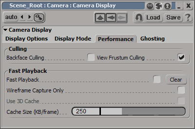

Ok, now that the fun part is over I’ll fill you in on what the other fast playback options do…
Camera Display
First and foremost is the cache size per frame. If some of your geometry is not showing up or you get a cache overflow message you need to increase this number. By default fast playback will use the current display mode when playing back so in shaded mode you will see shaded geometry. (Note: it does not support textured display though)
To reduce the memory per frame you can enable wireframe capture. There are two flavors of wireframe capture depending on whether the 3D cache option is enabled. If it is enabled then 3D wireframe data is stored. If not, then 2D wireframe data is cached. 2D wireframe data is stored in a packed format that uses about a third the memory of 3D wireframes. (and 3D wireframes usually use less than half the memory of shaded geometry) However, the memory savings from 2D wireframe caching comes at a price since you lose the ability to manipulate the camera during playback when using 2D wireframe capture.

    i was wondering tho.. about this 3d flipbook business.. i cant get it to work.
    after i follow all your instructions, i hit play and i get a “cache overflow” message at the bottom of the screen. the viewport goes blank, and after the caching run is over, when i hit play, theres nothign on screen but a few weird artifacts.
    is this a video card problem? or is my scene too heavy perhaps?
    thanks for your time!
  2. fouad says:
    ah.. and ive been upping the cache size to no avail
  3. I would suggest reading the last two paragraphs again. Have you increased the “Cache Size” slider and/or switched to wireframe caching to save memory?
  4. fouad says:
    hah! ok hid everythign in the scene except waht was important.
    and it works
    nice!
